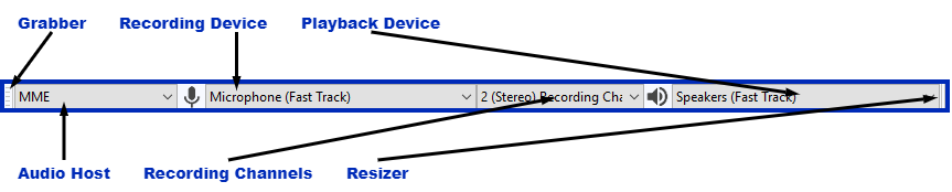

Thanks very much, Trebor. I followed your instructions, but found that all the options available, including the default, are 2 channel. My problem is with the front microphone input on my PC. But it appears to not be the PC that is having the problem. Rather, it is Audacity. When I monitor the microphone with headphones plugged into the headphone jack of the PC, I hear in my left ear only the sound spoken into the left mic, and I hear in my right ear only the sound received by the right mic. So the PC must be receiving and distributing the stereo correctly.
However, Audacity records both left and right mic sounds on both channels in Audacity.
Thanks for considering my problem.
There is an option in Audacity preferences as to whether to record in “2 (stereo)”
https://manual.audacityteam.org/man/device_toolbar.html
Can also try each the three different recording hosts to see if one of them gives you back stereo recording.
