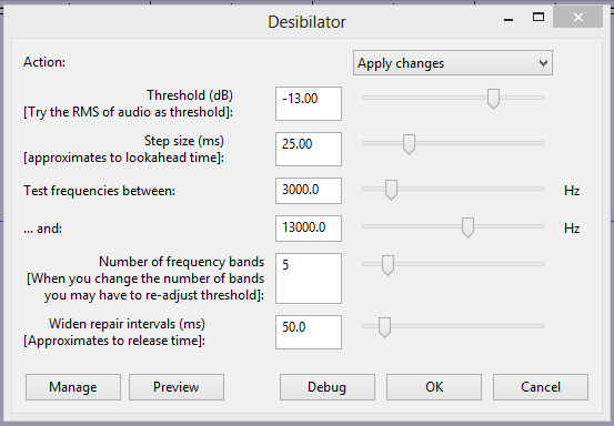

Sounds like compression has exaggerated the sibilance.
The cure is a de-esser plugin like desibilator …
You can get the same effect with excessive Noise Reduction. It might be good for us to sit in a corner and sort why effects do that. We know there’s a limit to what can be done with effects or the correction will take until next Wednesday. Nobody is going to wait that long.
