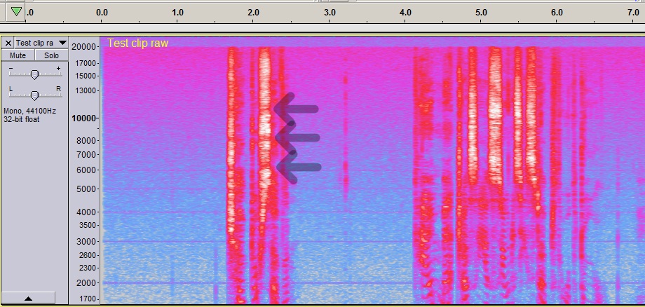

It’s a hollow, tube-like effect, that shows up on the spectrogram as notches …
A possible explanation is acoustic-feedback : sound of your voice leaking out of the headphones getting back to the microphone creating a phasing effect. As you move your head slightly that causes the effect to change , (the notches occur at different frequencies during the recording).
If the hollow effect goes away if you record without headphones plugged-in then you’ve found the culprit.
