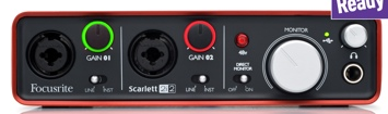

The focusrite has lights behind the volume controls in place of a sound meter. If the lights are green, then the sound is in normal ranges. If it’s off the sound is super quiet and it turns red for clipping. Many smaller mixers work the same way except not as artsy. Attached.
