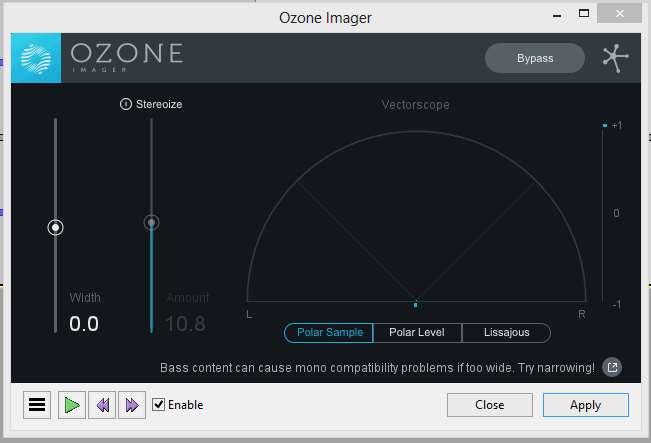

I’ve only used Hilbert transform to create a psuedo-stereo effect,
(only apply to one track of dual-mono pair).
