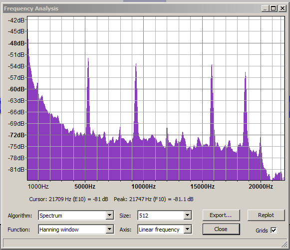

Clock noise ? , which can be removed by notching …
If it is clock artifact then a spectrum of a “silent” bit will have spikes at reqular intervals …
The spikes can be removed with a notch filter …
Notch filter#2 plugin for Audacity,( NY in ZIP).zip (628 Bytes)
BTW for some reason notching does a better job at curing this problem than Audacity’s noise reduction.

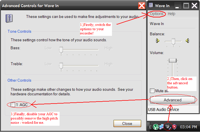

This worked for me and might work for you. [Explanation for Windows XP - working on an old PC right now.]
1.) Open your volume control in the taskbar [Bottom right-hand side.)
2.) Click options → properties
3.) Under “Adjust volume for” set the button from playback to recording, and click OK.
4.) Click advanced
5.) Under “Other Controls” disable the AGC.
AGC caused a massive volume burst and thus amplified the noise.
See the attached image if you feel my steps are bad :slight_smile:.
Good luck!
