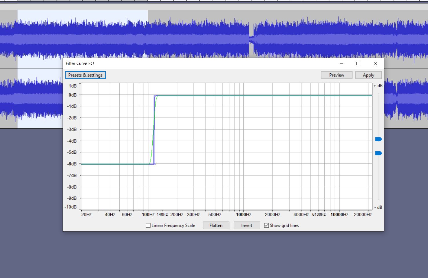

Problem solved. Filter Curve EQ did it. Thank you.
I made four curves like this, each progressively lowering the dB of all the frequencies under 120Hz.
