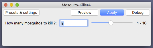

Since this is a common and known problem, we have a filter for it. Screaming Mosquitos. I’ll see if I can find it. It works by removing all or most of the tones in the whine, so it might affect your voice. It also depends on the computer using normal USB connections.
Post back if you find the problem.
Screen Shot 2024-06-04 at 6.41.42 AM
I don’t know where the actual software is yet.
This is the one I’ve been using.
Mosquito-Killer4.ny (363 Bytes)
It’s a nyquist program basically a bunch of notch filters at the right pitches.
