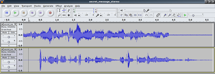

Steve, I did an important step, but it seems like magic to me:
1.) The sampling rate must be 44100Hz. Changed with hex editor.
2.) The ‘number of channels’ value in hex editor was 1 and I changed it to 2.
3.) Playing the changed file with Audacity you can hear on the right speaker the male voice with the text I posted above. But on the left speaker you can hear a female voice wishing a Merry Christmas. :smiley:
Well, in Audacity now there are two audio tracks, but only the second one shows waves, while the first one doesn’t show any waves. Do you have a dummy friendly explanation for this?
Thank you very much!
It does show waves but they’re very small, you need to amplify the secret female voice track to make the waveform more obvious …
Split the stereo to mono, select the upper (was “left”) track, and apply “Amplify” on default (amplifies by 40dB :open_mouth: ) …
Thank you very much, Trebor! Now everything is clear. :wink:
