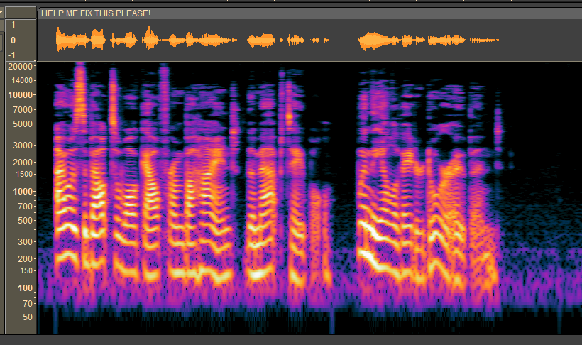

In this case a notch filter is required, as noise reduction is too blunt a tool to remove a tone
spectral editing
https://manual.audacityteam.org/man/spectral_selection.html#example
Thanks! Ive never used that tool before, can you offer any advice about how to set the parameters? At the risk of sounding like a moron, I struggle to understand a lot of the manual…
I’m not too heavy with the Spectrogram View. Not that I don’t know what it is, it’s that I have no hands-on with its tools.

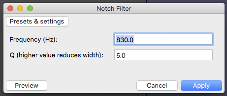

Try this.
Effect > Eq and Filters > Notch Filter
The tone isn’t gone, but it’s so far down in volume the work may be useful.
Do you have any idea what that is? It might be a tiny ventilation fan in the same room. Or my favorite bug-bear, the laptop ventilation fan?
Now that the tone is mostly gone, I applied gentle noise reduction.
Drag-select some of the Noise-Only to the right of the performance. Effect > Noise Removal and Repair > Noise Reduction > Get Noise Profile.
Select the whole clip. Effect > Noise Removal and Repair > Noise Reduction > 6, 6, 6 > Reduce > OK. I call that Noise Reduction of the Beast for obvious reasons.

spectral notch
Remove as little as possible: a notch will inevitably damage speech to some degree.
