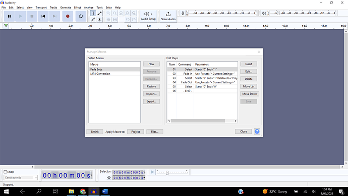

Koz, This is how far I’ve got. I’ve clicked on your link and downloaded the text file. Ive restarted Audacity and still it doesn’t appear. I’m using version 3.3.1

Do you have your machine set to reveal filename extensions? That’s the three (or more) characters after the dot in file names. If all you ever do is write letters to your mum and watch YouTube, you would never need them, but the instant you go for more complicated or out-of-the-way jobs, they become a Big Deal.
I bet you never got the Mastering text file from all that shuffling files around, but if you don’t see the .txt extension, you would never know.
You downloaded Audiobook-Mastering-Macro.txt whose real name is Audiobook-Mastering-Macro.txt.zip.
Double click on it (there’s the error) and it will add Audiobook-Mastering-Macro whose real name is Audiobook-Mastering-Macro.txt. You see how missing those three letters starts digging you a hole?
That should install with Audacity Macro tools and start working.
