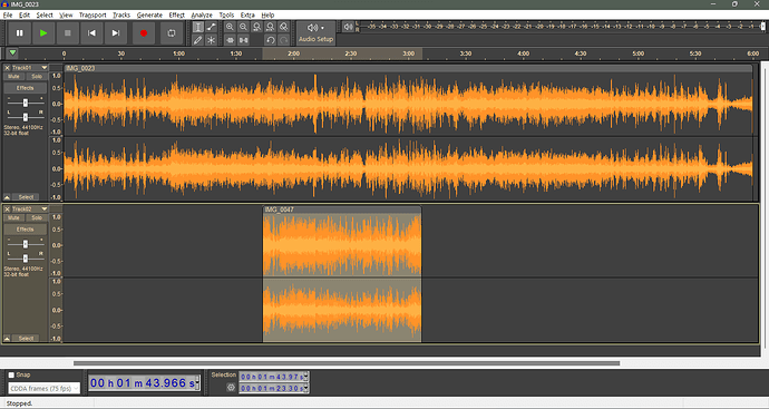

Sure thing. Here are the manual steps I would like to put into a macro.
Here are my two tracks…Track01 (top) and Track02 (bottom).
I then select all of Track02.
With all of Track02 selected, I then click Select → Region → Store Selection

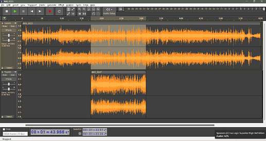

Next I place the cursor into Track01, then I click Select → Region → Retrieve Selection and as you can see below, the stored selection from Track02 is applied to Track01.

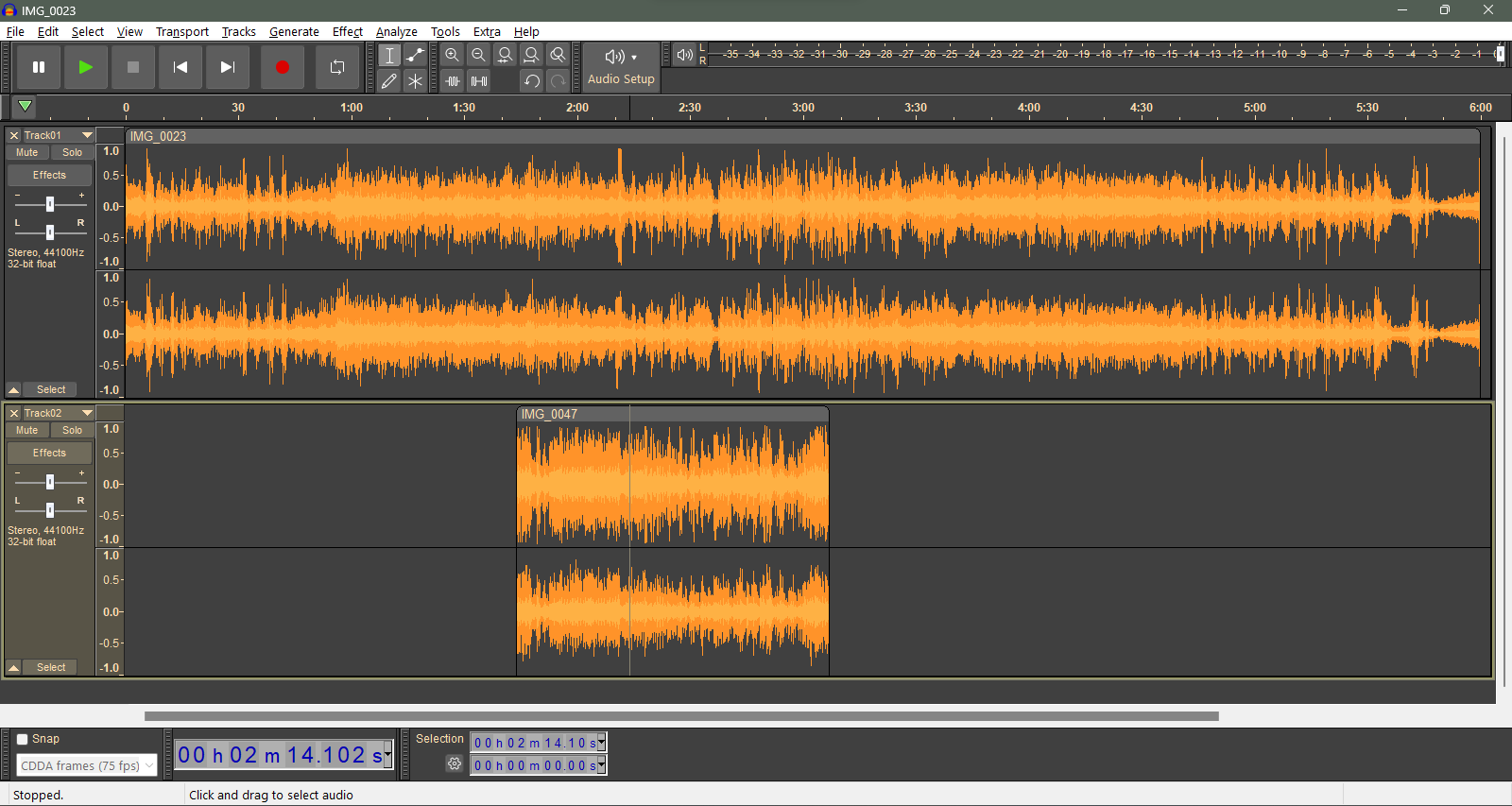

I can’t seem to find a macro command that selects all of Track02. This is what I have at this point, which is not working.
Thank you!
Yes; Try this:
SelectTracks:Mode=“Set” Track=“1” TrackCount=“1”
SelTrackStartToEnd:
SelSave:
SelectTracks:Mode=“Set” Track=“0” TrackCount=“1”
SelRestore:
