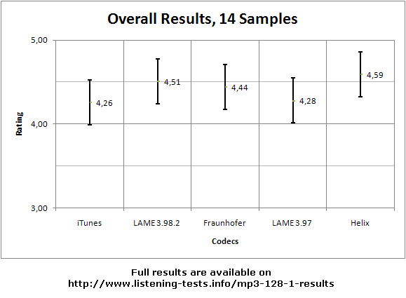

The most recent ABX listening test results that I’ve been able to find (more than one listener) date back to November 2008.
http://listening-tests.hydrogenaudio.org/sebastian/mp3-128-1/index.htm
These are the final results:
Information about interpreting the results (emphasis from original document):
How to interpret the plots: > Each plot is drawn with six codecs on the X axis and the rating given (1.0 to 5.0) on the Y axis. The number of listeners used to compute the means (average ratings) and 95% confidence intervals are given on each plot. The mean rating given to each codec is indicated by the middle point of each vertical line segment and the value is printed next to it. Each vertical line segment represents the 95% confidence interval (using ANOVA analysis) for each codec.
This analysis is identical to the one used in Roberto Amorim’s listening tests.
One codec can be said to be better than another with 95% confidence if the bottom of its segment is at or above the top of the competing codec’s line segment.
Important note: > These plots represent group preferences (for the particular group of people who participated in the test). Individual preferences vary somewhat. The best codec for a person is dependent on his own preferences and the type of music he prefers.
and the result summary:
They show that > all encoders are tied on first place> , except l3enc which of course comes out last being the low anchor.
What is interesting to see is how the MP3 codec actually evolved since its first days (l3enc was the first MP3 software encoder back in 1994 when it was released) and how it is still competitive with newer formats like AAC or Ogg Vorbis.
Another very interesting thing, which was also one of the goals for this test, is that Fraunhofer and especially Helix, which both outperform LAME in terms of encoding speed, are still very competitive. While statistically being tied to LAME on first place, Helix actually even received a higher rating than LAME 3.98.2 - and this at 90x encoding speed! Even FhG received a slightly higher score at least against LAME 3.97 which was the recommended encoder by the Hydrogenaudio community for a long time. > But again, statistically, they are all tied so there is no quality winner> .
