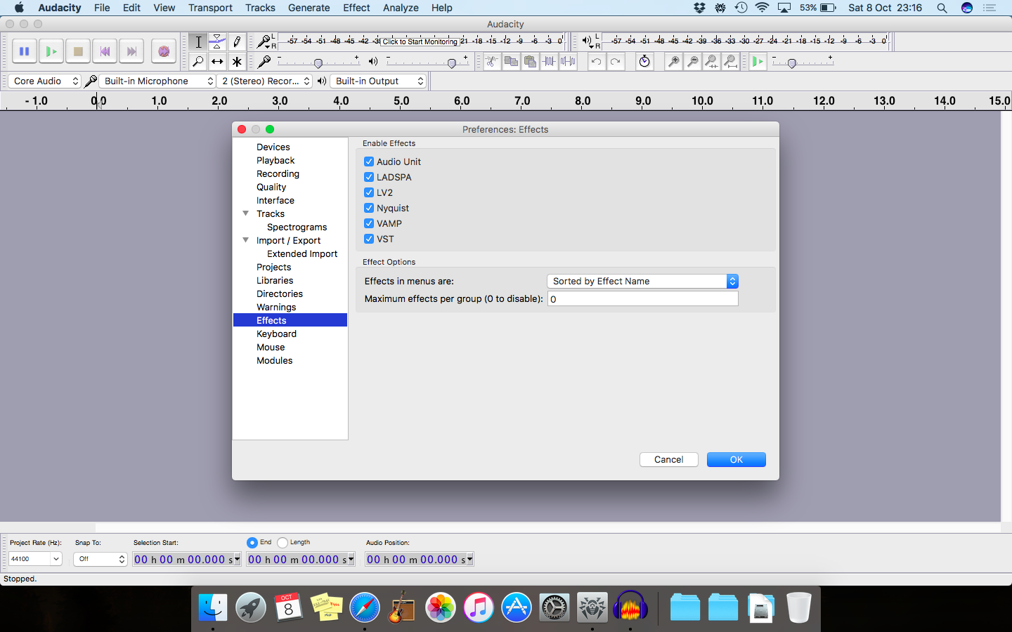

Look at Audacity > Preferences…, Effects section and ensure you have Nyquist and all other plugin types you want checked off (ticked).

I checked the Audacity > Preferences > Effects section and all plugins have been checked off / ticked. So I am not sure what I’m doing wrong.

Thanks Gale. They are all ticked. The plugins are still undetected…
