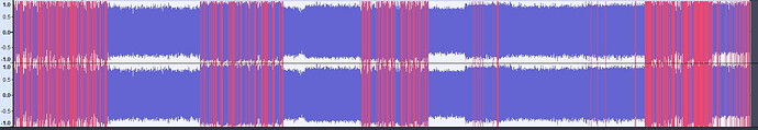

I have an audio track that is an aggregate of multiple tracks, and the amplitude on the combined track is all over the place, even on the individual tracks themselves.
I came up with the idea, right/wrong/indifferent, to normalize the track in chunks of time, instead of running normal normalization that processes the track as a whole so that way it will increase and decrease the amplitude where it needs to.
using the following script as a roadmap is someone able to get me home by adding the pieces to normalize the chunk at start-time though end-time.

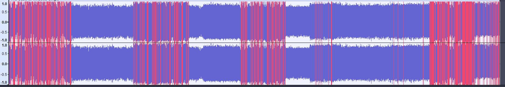

Try (legacy?) limiter : threshold -2dB, 10ms, no make-up gain.
