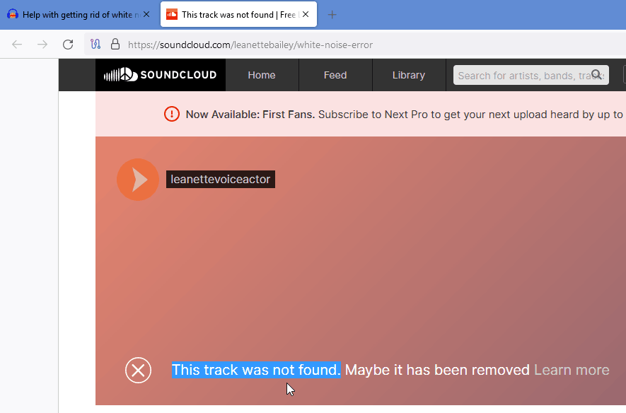

Here’s my sample: Sound Cloud
Audacity NR settings are 30/6/6
Not found …
BTW there is in option on SoundCloud to permit download of individual tracks.
Download is usually the original audio, better quality than recording the SoundCloud player.
