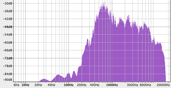

In a case like this the Plot Spectrum tool is your friend. For comparison, the spectrum of a normal voice and the spectrum of your sample.

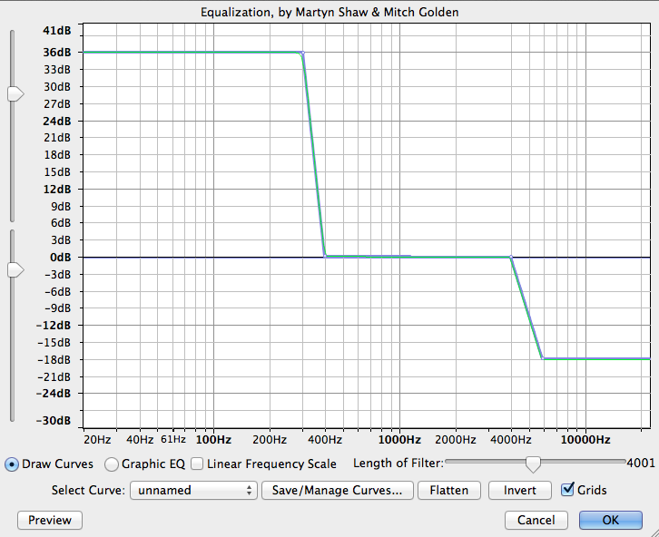

You can see that everything below 400 Hz has been heavily cut, and there is a boost above 4000 Hz. So cutting the high frequencies alone won’t help.
Try this as a starting point. You’ll never make it sound like a voice in an everyday pop song, but after this EQ it is somewhat less grating.

Worked. Thanks tons.
