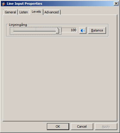

Make sure that the WDM driver input level for the AudioBox is maxed out. Open up the recording devices control panel, select the AudioBox…
and click “Properties”. Select the “Levels” tab…
… and adjust the input level with the slider.
With this setting I see no difference in recording levels between Studio One and Audacity on my system.

I checked the levels for the Line Input like you have, and they are set to 100.
How would I know if this WDM driver is working? Would that be the photo that you have below recognizing the USB Audibox with the WDM 2.8.40?
If so, then I guess mine is working properly.
