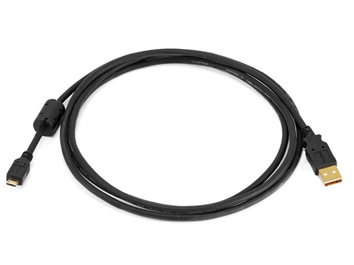

Well, what do you recommend? I need at least a USB A to Micro B to power the mixer and a normal USB A to B for the M-Track and that’s all the USB involved in the sound system.
  • does a quick Amazon search *
https://www.amazon.com/Tripp-Lite-Hi-Speed-Ferrite-U023-006/dp/B003MQ29B2/ref=sr_1_3?keywords=shielded%2Busb%2Bcable&qid=1639707116&sr=8-3&th=1
How do those sound?
