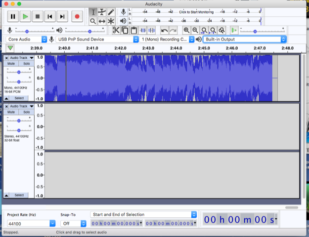

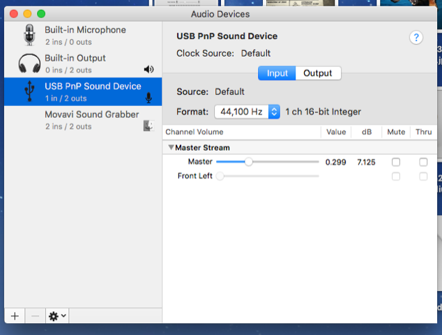

I was reading some other posts and someone said to open the MIDI folder and select the USB pnp and I did and I got sound. So I messed around and set it up like you see here, however its recording in 1 channel mono which sound bad, now how to configure this so I can record in stereo? I tried changing a few things and then it stops working.
In the device recordings if i select usb pnp I only get mono and it works, but if I change it to built in mic then I get 2 channel stero but it stops working. I hope I can record in stereo.

In Audio MIDI Setup click the Output tab and you should be able to select stereo.
In Audacity Preferences can you not select “Channels: 2 (stereo)” under Recording?
