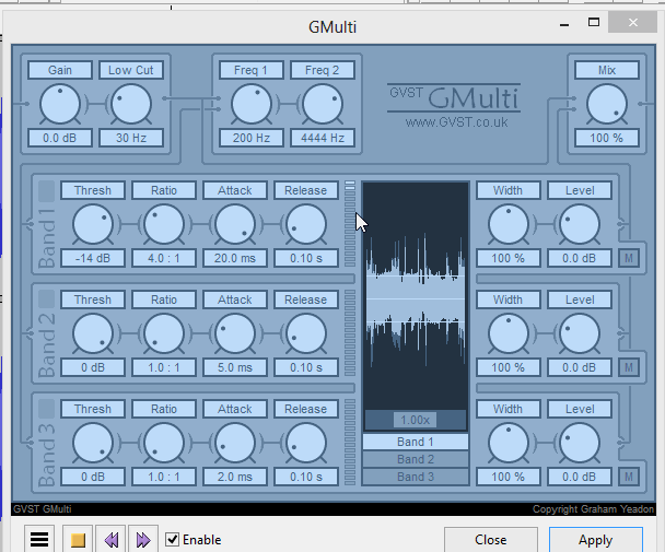

A muti-band compressor set just to compress the bass is a much quicker way of doing that.
This is good sound. But I don’t know how to make this sound with these 2 filters: /
Can ignore dirty-filter, it’s optional,
the important one is G-Multi set to compress the bass only, (i.e. “band 1” is the only one in-effect).
Ok thanx bro. Now is good :smiley:

“Band 1” level knob increases the bass …
If you want to expand, (rather than compress), the bass, the only free plugin I know which does that is “La Petite Excite”,
(it’s billed as an “exciter”, but it’s a two-band dynamic-range-expander)
