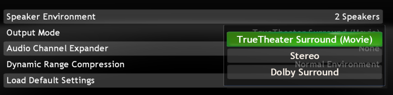

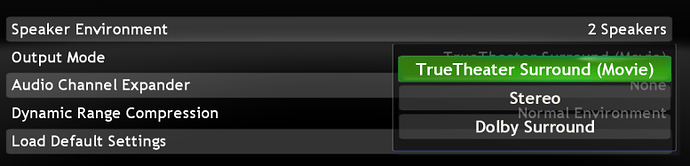

One possibility is that there are “Surround Sound” or other effects on the sound card in the new machine, and that what is happening is that the effects are being added to the recording you make, and again to the playback.
The tweaks, if there are any, will be in Windows Control Panel > Sounds and Audio Devices. Go through every option in the menus there, and turn off any sound effect options you find.

If playing old recordings, (made on old computer), on the new computer sounds echoey, but they sound normal when played on the old computer then it could be surround sound effect is switched on on the new computer. The surround effect only effects playback it is not on the recording: e,g, the surround sound echo effect would not be heard if the file was played via a portable MP3 player (e.g. ipod).
If the echo is on the recording no matter what device you play the file on then I’d look to see if the inbuilt mic on the new computer is live (see my previous post).
