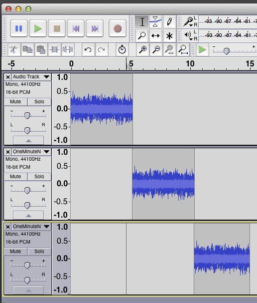

As a philosophy note, Import all your songs one after the other. They will appear one on top of the other and try to play at once. Use the Time Shift Tool (two sideways black arrows) to push the second track sideways (later), so it doesn’t start until the end of the first one. Repeat with all the others. You’ll end up with a stair-step affect on the timeline. Then cut and shift each one to what you want. Audacity will smash it all into one sound file when you Export at the end.

File > Import all the tracks and they should stack up one above the other and play at once. Use the MUTE and SOLO buttons to the left of each track to tell which one you want to listen to. Import track 1 twice, first and last.
As an exercise, do that Time Shift Tool thing where you push track 2 and then track 3 and then track 4 and track 5 which we’ll assume is the duplicate of track 1. Attached example. Click on the graphic or scroll.
Play it and you should get the songs in the right order. Click in the time bar above the blue waves to jump ahead.

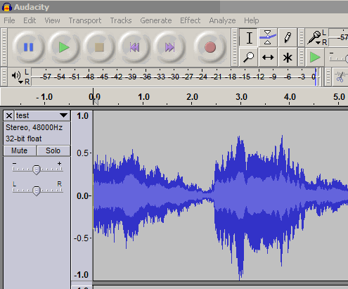

If the cursor is on the timeline when you select, it auto-plays when you release the left mouse button.
If you keep the cursor on the waveform (& off the timeline) when you “drag to the right” it doesn’t auto-play when you select : you have to click on the play button to play the selected audio …
If you prefer you can disable quick-play in Audacity.
