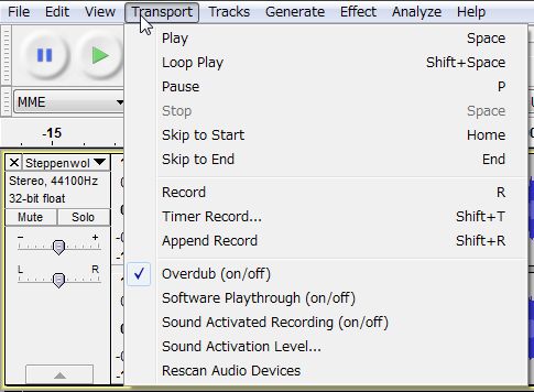

What I am wanting to do is record only the vocals when I have uploaded an instrumental track, but whenever I try, the instrumentals are recorded along with the vocals. This then creates a track with the vocals and instrumentals, along with the instrumental track I uploaded. This is not what I want. I want to know if there is a way to record the vocals only and not have the instrumentals record. Of course, there would still need to be a way to hear the instrumentals so I can be sure of staying in sync with the song. I thought overdubbing would help solve the issue, turning off that feature that is, but whenever I play the song via other means, it still records all of the instrumentals.
Overdubbing is something I have tried, I tried once more, and it did not give me the results I was searching for. However, I did use my iPod to play the backing track while I recorded only my vocals, the track I uploaded to Audacity I merely muted so it would not record while I recorded vocals.

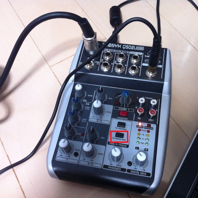

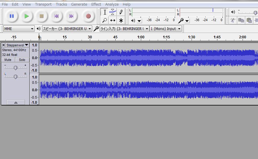

When [To Main Mix] on the 1st pic is pressed down, I get the backing track and my vocal recorded (Red line on the last pic).
When release, no backing track and I only get my vocal sound recorded. (Green line)
Please advice. Thanks!

Just glancing at your posted photos, I’m going to say this is not an Audacity problem, it’s a mix problem. If I understand correctly, you want to hear the music and your voice at your headphones. You’re recording to Audacity from the Main Mix output. When you press that button down, it sends the USB signal to the Main Mix, and anything at that output is recorded.
Try using the button above that: (USB/2-Trk) To Phones. You should now be able to here both the music and your voice in the headphones but only your voice signal will go to the Main output to Audacity.
Thanks for pointing me out. I did try the button above “to phone” but there will only be my voice and there is not backing track coming out of the headphone.

Jess, in broad terms the answer is in numerous posts in this Forum - turn on Transport > Overdub, choose the mic you are recording from as recording device in Device Toolbar and wear headphones.
