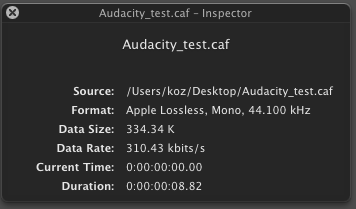

This is what QuickTime 7 thinks is in that file (pix). I’m out of ideas. Koz

iTunes won’t open CAF files containing Apple Lossless even on Mac.
The reason Audacity is crashing is because the FFmpeg latest version for Audacity that you have (0.6.2) is crashing trying to import the file. That version of FFmpeg can import 16-bit Apple Lossless, but not inside a CAF container.
The reason you could import the file before is that either you had the previous FFmpeg 0.5, which doesn’t attempt to open the file, or you did not have any FFmpeg installed. In those cases, Audacity’s QuickTime importer (which can open the file) gets a chance to open it. This importer is Mac only, so this CAF file is unimportable on Windows.
