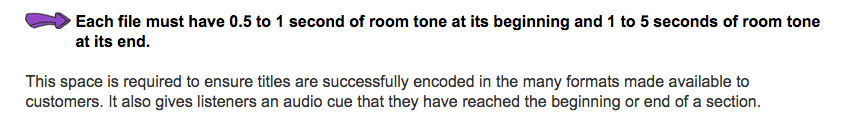

Their job is to publish valuable works for sale and split off damaged works as quickly as possible. In my opinion, I would look at the ACX Audiolab ratings and check the MP3 compression. Check the silences (room tone) at the beginning and end of each chapter. Check format conformance (chapter headings, attributions, etc), briefly listen to the chapter ends and beginnings, the beginning and the end of the book, and then spot check at random. They’re a business. Checking your book can’t be a career move, and those are the places presenters screw up the most.
There are stupid, right-brain errors. Putting the wrong number of seconds of room tone (silence) before and after each chapter is surprisingly popular. That is a clear, stated requirement.
