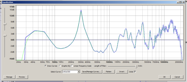

Here’s an equalization-curve which will convert sample2 into sample 1 …
Rather than redraw that curve , (or an approximation of it), you can import that “UnRat300” curve into Audacity’s equalizer via the xml data file below …
UnRat300.xml (52.9 KB)

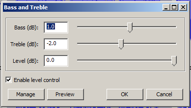

UnRat300 is close to the desired result , but a final tweak is required …
Here’s a before-after …
then a Limiter.

The curve UnRat300 was primarily created via Steve’s experimental plugin “SpectrumToEqCurve.ny” , but needed a manual adjustment: a peak at 300Hz, ( because the data-points on the curve generated with Steve’s experimental plugin are too sparse at the low end , even when using the maximum 2048 points ).
