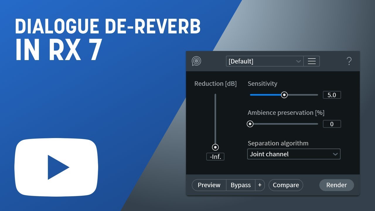

De-reverb filters exist, but they’re expensive and not a 100% cure …
