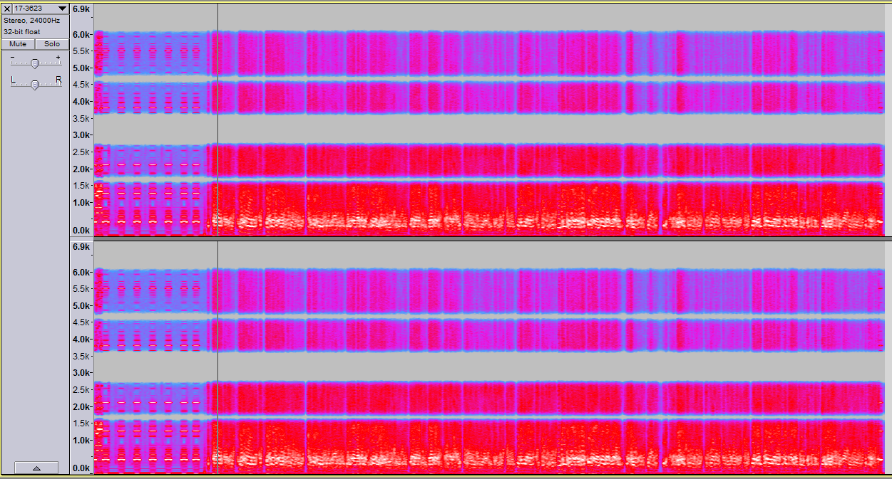

The recorder is quite basic, and apparently it’s not possible to set it up to record at a lower volume. I’ve been fiddling a bit with Audacity but haven’t managed to improve the quality of the recordings. The Clip fix effect doesn’t seem to help. Something that has surprised me (maybe just because of my lack of knowledge about audio waves) is that three band frequencies are missing altogether, roughly 1650-1750 Hz, 2750-3650 Hz and 4600-4800 Hz:

Once you clip audio, that’s the end of the story. Clip Fix is for the occasion where one brief sound or vocal expression goes a little over. It will not turn ten minutes of burning devastation into clear audio.

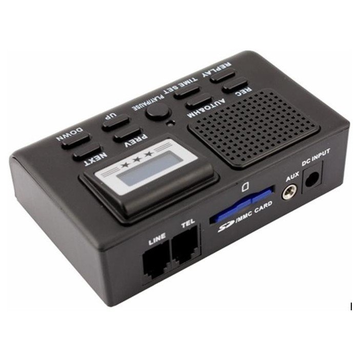

I don’t think that helps in this case. This is a landline recorder which connects directly to the phone line. If Audacity can’t help to improve the audio quality, I think that’s the end of the story. Still, I post a few pictures of the recorder to clarify just in case:

That was awesome. Great quality improvement! The quality is still poor, but the sound is not annoying anymore. I will definitely get a better device in time, but in the meantime this is sweet. Thank you!
One more question, though. Is it worth fiddling with the equalization values to improve a bit more the quality or is this close enough to the best you can get?
