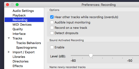

Hearing the singing voice through the headset when I use the USB mike for recording the song with sound track. How can I setup the usb mike and the head set not to hear my singing voice through the head set(I want to hear only the sound track) when I singing with sound track through the USB mike.
The first of those preference selections lets you hear background music while singing. The second tries to push your live singing off to your headphones.
Thank you very much, really appreciated.
