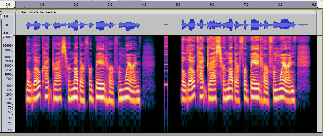

I’m nit-picking here, but I can hear (and see) resonance.
mother forbade, before-after
(before-after)
A plugin to treat resonance is Sonible’s PureEQ, (30 day free trial).
It’s dynamic control reduces resonance and sibilance … https://youtu.be/YUgNBNVTFvU?&t=323

Head exploding. You have solved the mystery of the line on the spectrogram, I didn’t know what it was till now, thank you. I can’t hear it per se (or maybe just don’t know what I’m listening for), do you mind sharing how that resonance is effecting my output/vocal quality? Wonder if it’s something I can leave or need to deal with.

It shows up on the spectrogram and spectrum plot …
Strong resonance sounds like Darth Vader. Yours is just slightly Vaderish.
The “after” version here has the resonance reduced, (and a different EQ) …
(before-after)
Removing slight resonance is akin to giving a final polish, (your competitors will be doing it).
The automatic de-resonance plugins range from $20 to $200. The one I mentioned varies in price from $20 to $40, (with a very generous 30 day free trial).

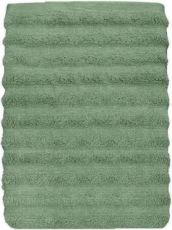

I use a towel like this. The ridges absorb the echoes that would bounce off the table.
