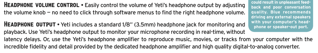

I think you have something else wrong. Your own voice comes from the Yeti, not the computer. This is from the Yeti instructions.
No software clicking and no latency because your headphone voice comes from the Yeti.
The full blue box on the right has a warning not to use the headphone connection for speakers in internet conferencing because it doesn’t follow the computer sound services. It’s self-contained.
