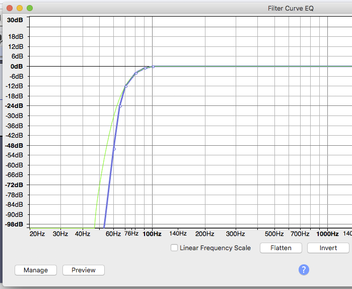

Oh. I remember this. You had to import Low Rolloff for Speech custom curve and settings into Effect > Equalization and then be careful how you used it. That’s the rumble filter needed because so many home microphones have low pitch noise and distortion.
Attached LF_rolloff_for_speech.xml.zip
LF_rolloff_for_speech.xml.zip (326 Bytes)
Unzip it to the .xml file and install it in Effect > Equalization. I’ll remember how to do that any minute now.
You sure you can’t borrow a more modern computer for a while.
Effect > Equalization > Manage > Import: point it to the .xml file > OK.
And then run it. I don’t remember the magic for that, but when you get it installed and running, it should look like this.
If you have a very deep, rumbly announcing voice, Low Rolloff may take a little of the gutsiness out of it, but it’s worth it because of everything else it does.
