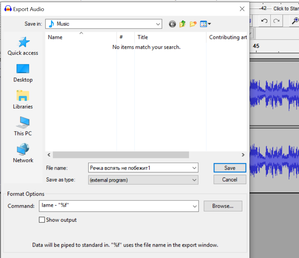

“External program” export - I don’t quite understand. A window opens with the lame command and something further. And how can I choose a format and bit-rate now? And other options that were available in the usual mp3 export?
These options? How can I choose? Preset, variable, stereо, joint stereo…
The “external program” export option allows you to specify any command line encoder that you have installed on your computer.
Examples are included for “lame” and “ffmpeg” command line encoders.

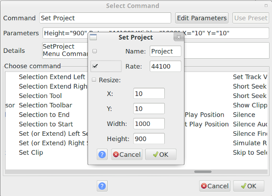

You’ll be pleased to know that subject to testing, this should be available in the next release (scheduled for January).
Thank you!
In the new alpha version (dated 22.10.18) the Set Project option works quite normally. Thank you!
