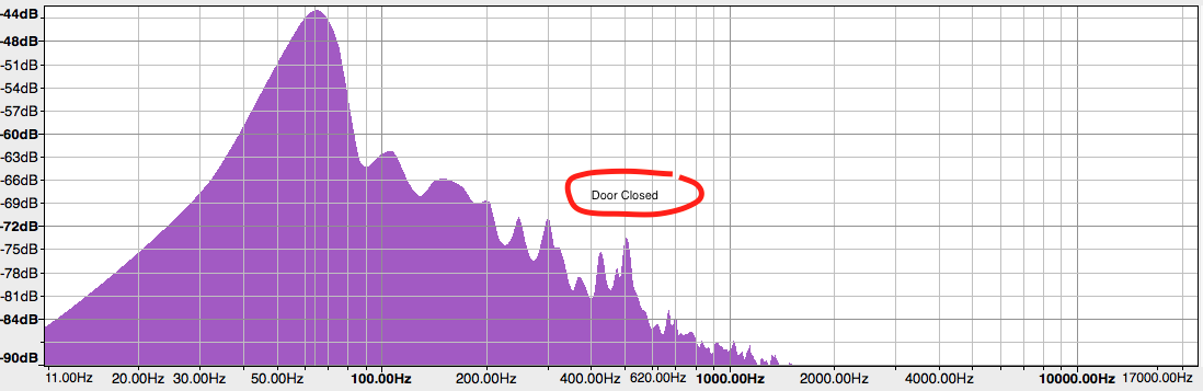

I’m having to record this in my garage. There’s not really any place else in my house to record it, and since it’s pretty much a “personal project” at this point, I really don’t want to shell out hundreds (or thousands) for studio time. My garage is already rather full, so I can’t really “sound treat” anything. I’m having to “make due” with what I have. Which leads us to…
My absolute biggest problem is background “noise”. I remedied most of it simply by upgrading my microphones. Are there any other effects (other than those I note below), and in what order can I apply them, to reduce noise as much as possible? As I said, this is purely a “personal” project for now, but I haven’t decided if I want to sell copies or not, but that’s for a different post. But I still want it to sound good.
I’ve tried using the Loudness Normalization, Noise Reduction, and Normalization features, but as I said, I’m very, very new to recording/tweaking/mixing. I know the answer to “how much background noise is acceptable” is probably “none”. So if there’s a way to get rid of the background noise completely, I’m all ears. I kinda-sorta can get rid of some of it (though I haven’t written down how), but then when I raise the gain on that track pretty high, I still hear noise, although it’s in the -48db range. If I leave the gain at 0, it’s like the background noise (which is usually that ambient “hum” or some call it “rumble”). I tried turning on the -20db setting on my P170, and unless I’m doing something wrong, or don’t understand what that switch does, I don’t like how it sounds. It doesn’t sound quite as clear as it does when it’s set to 0.
