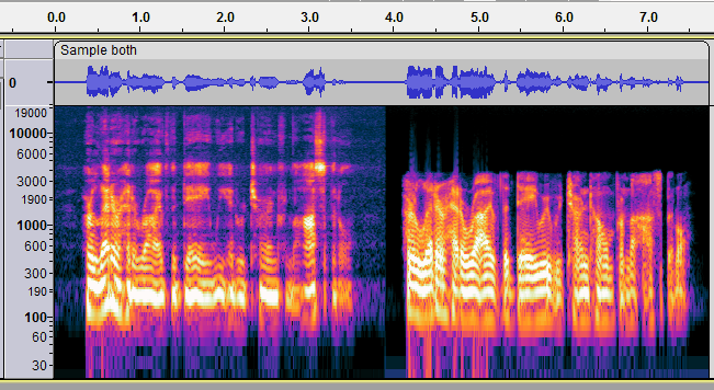

Yesterday, for the first time, I used audacity to make several recordings and the quality was excellent. Today I went in with, I thought, the exact same settings and setup and the quality is noticeably worse. I can’t understand what happened and if there’s a fix for this. Here is a sample of the good, then the not so good.
Any help or ideas is appreciated.
The second version is highly processed (AI?)

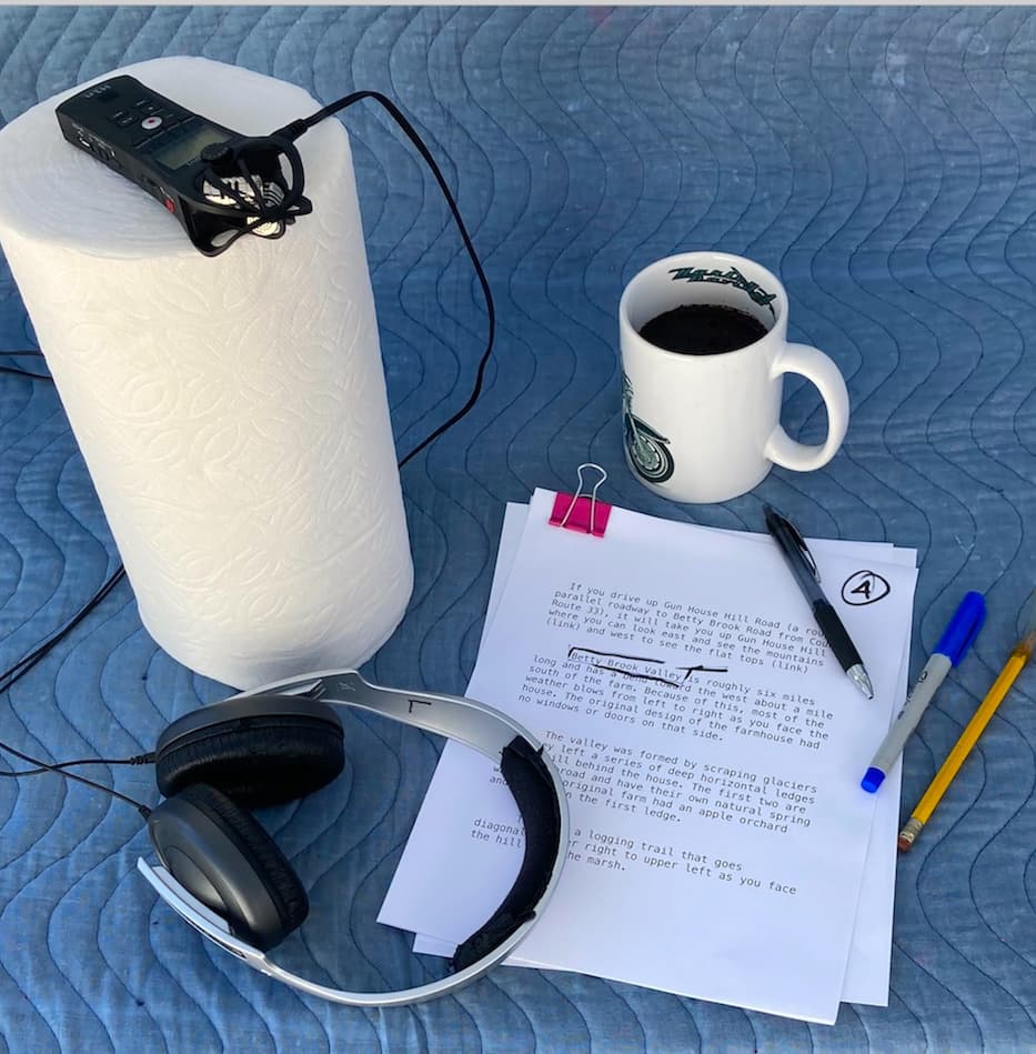

That’s a Zoom H1n stand-alone recorder in full studio configuration.
Dig that groovy mike stand/tripod … :wink:
Note the heavy blue furniture moving pad on the desk.
I have a second microphone mount where I found rolls of coloured towels. One in a car parts store and another from the specialty cleaning department at Vons Grocery
Actually, if you can insure that the table or the floor doesn’t make noise, you can do very well putting the recorder right on the table. That’s Pressure Zone Configuration, if any body asks.
Voice volume doubles, the electronic noise goes down by half and the character of the microphone doesn’t change.

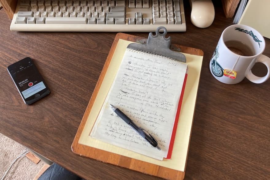

There are certainly opportunities for missteps. But, just to do it, I recorded a short “chapter” on my phone in my quiet bedroom. A note. That’s an iPhone and I’m recording in Lossless Voice Memo. So it’s not crappy sound.
Using just that, I was able to produce a chapter that passes ACX Submission Standards.
