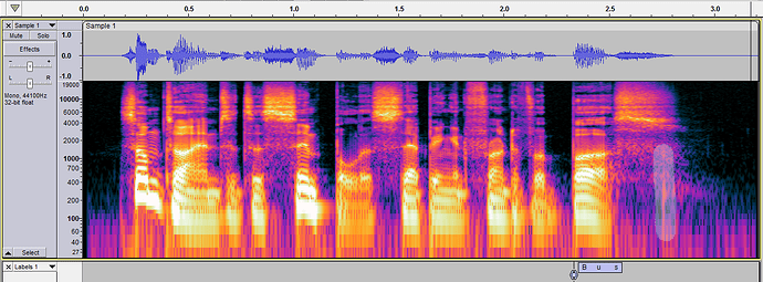

I’m using a RODE NT1-A to record an audiobook in Audacity with a Focusrite Scarlett pre amp, but there is a recording issue I haven’t been able to resolve after lots of troubleshooting. Basically, there is a clanging sound that appears at the end of some sentences and it is happening in every recording no matter what I do. It seems to increase the longer I record and is always at the end of a spoken sentence, never before or in mid speech. Occasionally it will overlap with the final spoken word but is mostly right after. I have have saved some samples…
Sample 1 - This sample is just a raw clip of the sound at the end of a sentence.
Sample 2 - This is the sound isolated and amplified so you can hear it better.
