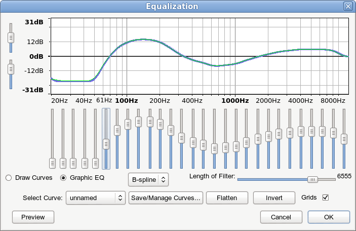

I’d say you’ve a beautiful voice if the low end is properly boosted.
You can of course use the Equalization effect instead. It’s a little trickier because we have 3 amplification points (200, 650 and 4000 Hz), not only with different gain values but also with a different width (ranging from 0.6 octaves to 4 octaves).
In which case you would want to use settings something like this:
Also, applying some dynamic compression will help. As a starting point, try these settings:
