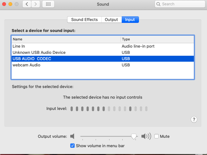

Can select it and even get a moving input level showing in Sound Preferences when I play a disc but no matter what I select in outputs I can’t get any signal. I have other USB sound inputs and they all work fine with Headphones port and HDMI/monitor speaker. But nothing will connect to Audacity, not even the Web camera audio. Beginning to think it’s something to do with the Mac.

I still don’t completely understand.
If you are seeing the Rega input in Sound Preferences, then you should be able to select it in the Audacity Device Toolbar as a recording device. Can you do that? Are you saying you’ve done that and get a flat-line recording?
You say “No matter what I select in output nothing come trough … When I press record there is no signal.” I don’t understand this. You need to select the Input (recording device) in Audacity to choose what to record, not the “output”.
In Audacity, if you select the built-in microphone as a recording device, can you record the sound picked up by the internal microphone?
Does Audacity have permission to access the microphone in System Preferences > Privacy and Security > Privacy?
