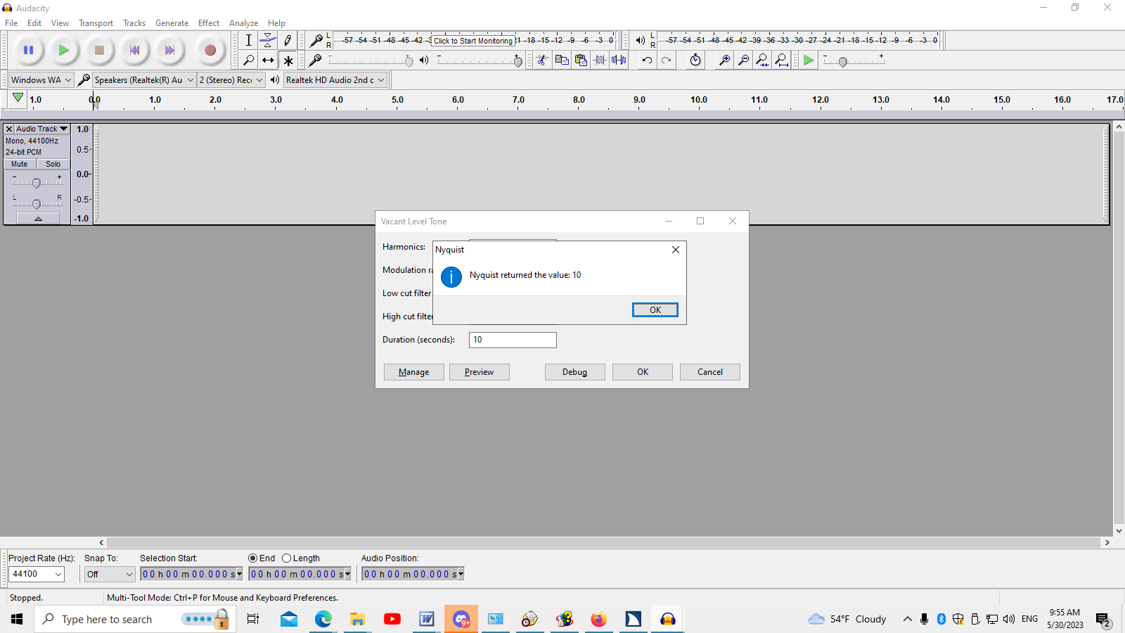

Funny when I try the parameter, I get this:
Ensure that you copied and pasted the entire code.
Including all blank lines?
Yes, Steve, that works, and is magic regards generating a modulated tone, 10 secs length with pulses and long silence gaps.
