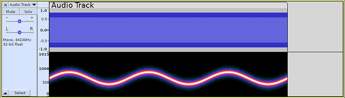

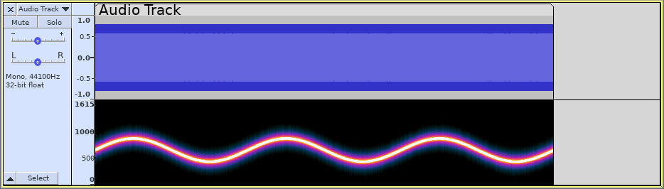

I barely know anything about music, but here is my question.
Anyway, I know that a “simple” tone of certain pitch is actually since wave of certain frequency… Now, what I need is a simple tone that changes its pitch (frequency) in swinging fashion, with certain swinging period (say every 10 secs), meaning, although the tone itself is a since wave, but the frequency should also change in sine fashion between 2 frequency boundaries (min and max frequency). Thus, one would hear pitch swinging in sine fashion between 2 limits (lower and upper).
I read that Audacity has something called frequency sweep, but it seems it offers only linear and exponential change of frequency, whereas I need sine function of change.
Is it possible to do something like this in Audacity?
In electronics that’s frequency modulation (the higher frequency is modulated by the lower frequency). In music it’s vibrato, although 10 seconds is longer than “normal”. String players and singers use it a lot.*
I don’t see a built-in effect but there is an optional [u]vibrato[/u] plug-in, or if that doesn’t do exactly what you want you should be able to find 3rd-party plug-ins.
