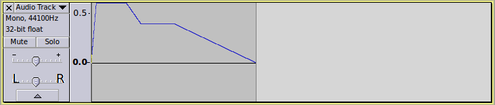

I’ll split up your code into sections, and demonstrate what each bit does:
(setf adsr (pwlv 0 0.05 1 0.3 0.4 0.5 0.4 1 0))
This creates an “envelope”, which is a low sample rate control signal.
A “control signal” is just a “sound”, but at a low sample rate, and changing much more slowly that a normal audio waveform.
By default, “PWLV” creates control signals (“sounds”) that have a sample rate 1/20th of the track sample rate.
If you return this kind of “sound”, on it’s own, back to the Audacity track, the length of the sound will be 1/20th of the length that you generated.
The sound returned by PWLV is assigned as the value of “adsr”.
Example,
(pwlv 0 0.05 1 0.3 0.4 0.5 0.4 1 0) creates a signal that has length “1”.
If this is in a “generate” type effect (in the Generate menu), then that is “1 second”.
If this is in a “process” type effect (in the "Effect menu), then “1 unit” of time gets stretch to equal the length of the selection.
The “Nyquist Prompt” is, by default, a “process” type effect, so running this command in the Nyquist Prompt will return as sound that is 1/20th of the length of the selection:

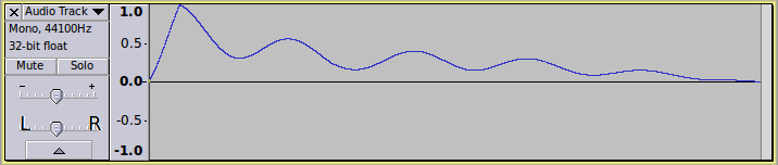

SIM is the same as SUM, and is simply a function for adding signals or numbers.
(setq wiggle 0.3)
(setq wigglerate 3)
(setf envelope
(sim
(mult adsr (- 1 (* 2 wiggle)))
(mult adsr wiggle (sum 1 (hzosc wigglerate)))))
So here we are adding the envelope (mult adsr 0.4), with the wiggly line created in the final line, and assigning the result as the value if ENVELOPE:
We can now multiply this envelope with any sound that we like. In the initial code, it multiplies the envelope by the sound from the Audacity track “S”. Alternatively you could generate a sound, and multiply (scale) it with the envelope, for example, here I generate a 440 Hz sawtooth waveform, and multiply it by the envelope:
(setq wiggle 0.3)
(setq wigglerate 3)
(setf envelope
(sim
(setf my-saw-waveform (osc (hz-to-step 440) 1 *saw-table*))
(mult envelope my-saw-waveform)
