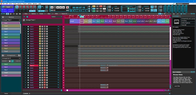

As an example, Cakewalk does provide “Arrangement Mechanisms” so the audio (and I am not sure whether MIDI tracks are supported) tracks can be broken into named segments and can be rendered in different orders and many times. This is extremely useful, but as a side note is a far cry from what I can do with my Python program.
See the colored segment labels in the bar above the midi tracks, and arrangements on the left side. (I am sure the picture is too crowded for readability). I will try to post just those portions a little later.
