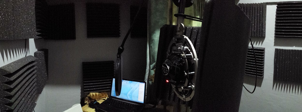

Progress was being made on the (long awaited) first actual audio book when I decided I ought to be more comfortable in my booth (it was causing me some back-ache the way I had it). I lowered the microphone arm a shelf, took away the stool, added a chair and also took away the rickety old box (my former mini-booth) which the laptop was resting on. I still have room to stand when I wish but for long sessions I may now actually sit comfortably. Please see attachment.
For the benefit of Golden Ear, I am positioned near one of the corners of my booth in a chair with a thick cushion. To my left is a small table with the laptop. In front of me is the boom and microphone. It is still fairly close to the centre of the room but (obviously) a little closer to the corner I’m sitting in now. I still have the Auralex tiles and the Auralex Mudguard but to my immediate left is a large blank space (which I shall rectify) where the old mini-booth used to sit atop the table.
Unfortunately, this has lead to a hideous, unwanted background noise which I’ve yet to pin down. I thought it might be the refrigerator as the kitchen is next door and now that the box has gone and I’ve not yet put up foam in its place, it was bleeding through. The sound appears even when the 'fridge isn’t noticeably humming, however. Then I discovered it seemed worse if the cable I bought (as recommended by you all) for the microphone was closer to the laptop (as it all is now with the new setup) so I tried moving it further away whilst still maintaining the new layout. Again, no joy.
So I must come to you masters and hope that you still have the time and patience to assist me.

    I definitely plan to put up some dampening on the wall right next to the laptop where the box used to be but I don’t think that can be the only thing can it?
Thank you in advance.
