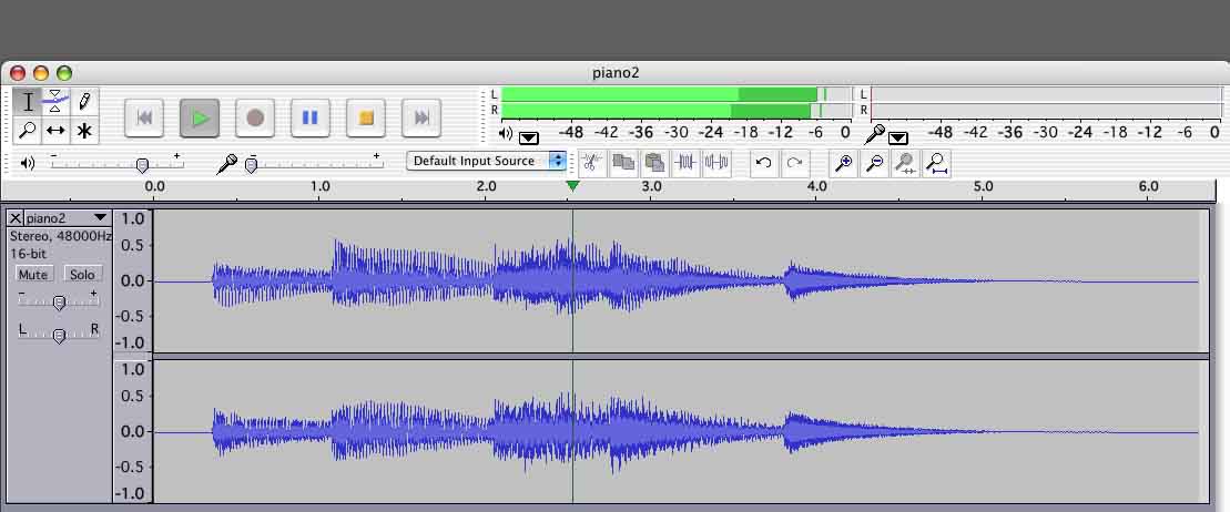

When you’re playing a clip, doesn’t your timeline look something like this?
There are two problems and we can’t tell where your popping is coming from, so we’re trying to solve everything. DC Level Problems are when you stop talking and the blue waves do not settle at 0 but either too high or too low. That’s what Remove DC fixes.
That first illustration with the gentle up and down waves uses a pure tone like a flute as an example. Your voices or music are going to be much more complex and harder to deal with. That’s why you should try editing clips with the DC removed first because trying to edit individual waves within a musical selection can be very difficult.
