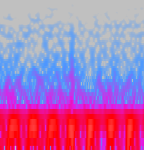

I switch to the spectrogram view and see this: (default window size reduced for better visibility)

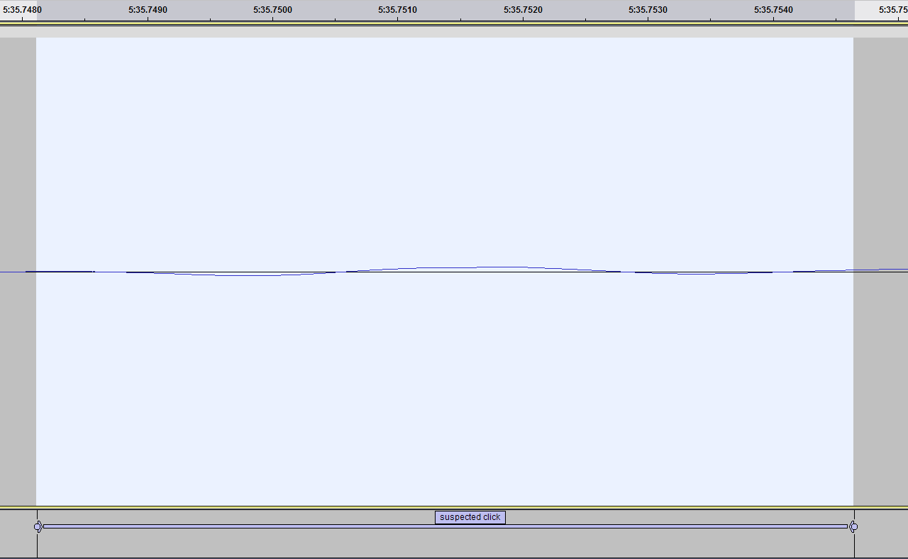

I select that bit (about 200-something samples), switch back to waveform, which is in its default Linear mode, and I don’t see anything too out-of-the-ordinary.
I am convinced that the problematic part is this - as I play the track before or after it, it’s all clean, no clicking of any kind.

It won’t let me attach more than one image per post, so here’s the waveform view.
That little bump at approximately 5:35.7486? I’ve fixed it, it doesn’t change how this sounds.
Spectral editing … https://manual.audacityteam.org/man/spectral_selection.html#eq
thats pretty fantastic for a free, built in, editor
That’s amazing and just what I needed, thanks!
So what I did: I’ve selected that long purple bar (without the pinks and reds) > Spectral edit parametric EQ > set its gain to -10 dB. I can no longer hear the click, and the spectrum looks visually good and clear. Perfect.
