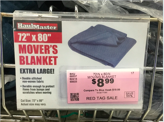

Found it.
That’s from Harbor Freight in California. This soundproofing thing doesn’t have to cost thousands.
I put two of those over my metal garage door when I did the Evening Messy Garage Voice Test.

Ah thank you for that. I’m heading to the Australian version of that hardware store today! Will try and build the contraption then will record the test on my current h1 zoom to post it here again… It’s insanely difficult to see the volume meter, I had it on input level 80 then had to do this to get it to comply with ACX check:

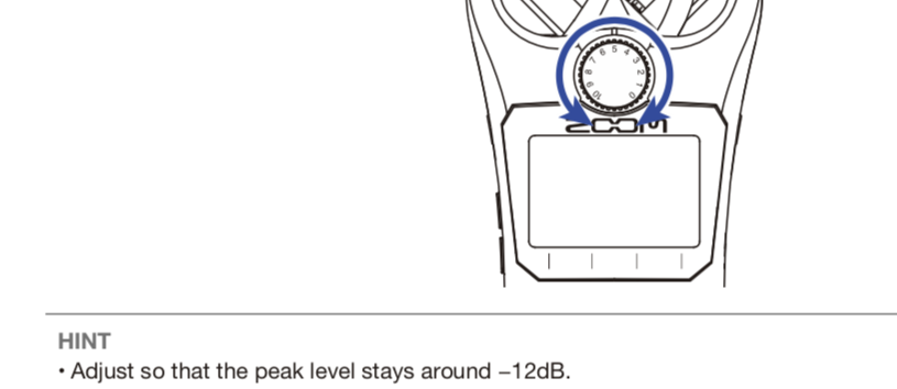

It’s not a good goal to try and read directly into ACX standards. The fuzzy goal is to have the voice peaks at -6dB to -10dB. In Audacity that’s the tops of the blue waves at about 50%.
This is from my Zoom manual.
-12dB is right in the middle of my Zoom sound meter.
You can easily get your voice from there to any sound standard without damage. You can get a little louder without clipping or overload damage and quite a bit quieter without additional noise.
Avoid having the sound meter go up to 0dB and the Audacity blue waves go to 100%. That’s where the recorder stops following your voice and starts making up its own trash. The distortion is immediate, severe, and non-recoverable.
