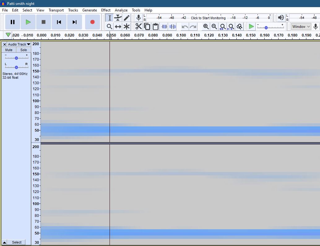

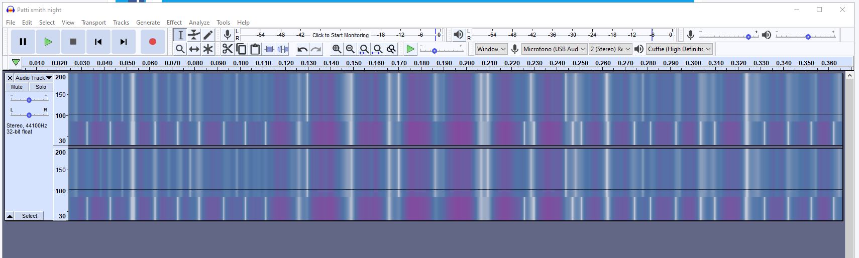

I’m trying to understand how it works, I have selected the range from 30 to 200 Hz looking for traces of harmonics or subarmonics of my 50 hz power. (see attachment)
I need to make some tests to better understand, but the suggestion looks good

increasing the window size gave me amazing results…
The 50 HZ note is quite wide it goes from 40 Hz to 60 Hz but, there are some harmonics around 85Hz and 125 Hz that are multiples of 42 Hz
So this shows, I am not wrong, that the track has slow speed and must be increased.
Just one thing is not clear, I cannot explain the presence of the harmonic at 150 Hz it seems stronger than the 85 and 125 Hz.
This could mean that the speed is ok and 85 and 125 are traces of a previous recording, on another device, not completely erased??
I am going to study the frequency-analysis plot as you suggested
Many thanks again Trebor for this incredible trick…
