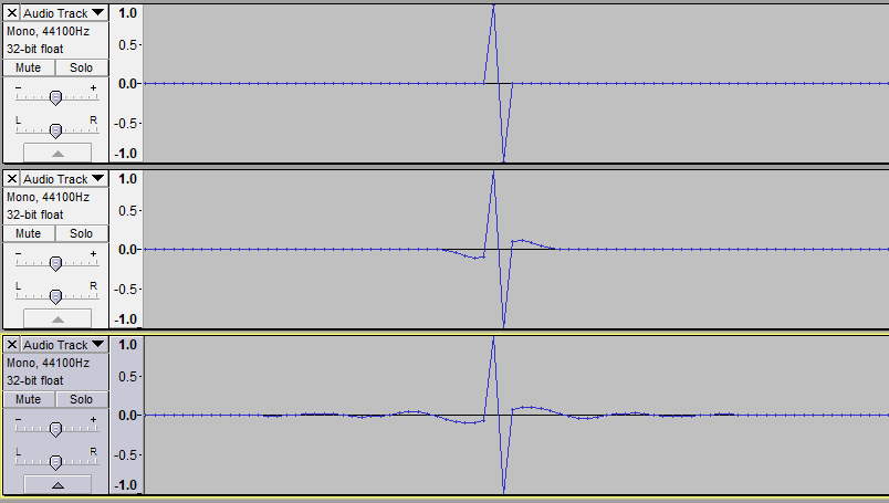

In the image below, the first track shows an impulse (no effects), the other two tracks have had EQ applied. The EQ settings are the same for the second two tracks except that the second track has a small “Size” and the third has a large “Size”. Notice that there is considerably more “ringing” in the third track. The ringing is an unavoidable consequence of the larger window size / filter length. To retain good transient response the filter length should be kept as short as possible, but for good frequency resolution the filter length needs to be long:

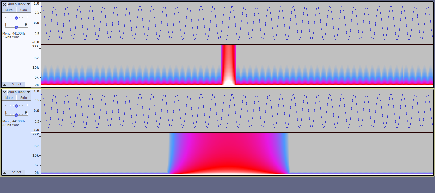

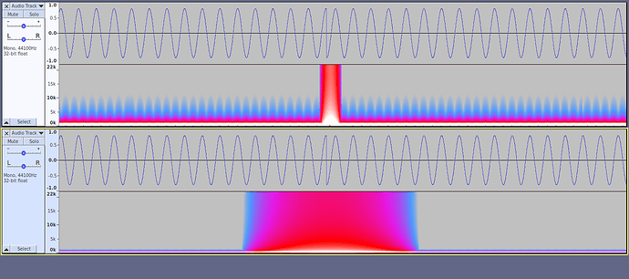

The same effect can be seen in the track spectrogram view.
The first track below has a window size of 128. Notice the discontinuity in the waveform is quite narrow in the spectrogram, but the steady tone is poorly defined.
The second track has a window size of 1024. Notice that the steady tone is fairly clear white line near the bottom of the spectrogram, but the discontinuity is poorly defined.
This is not more ringing, this the frequency resolution has increased. There is no bell on a good convolver.
