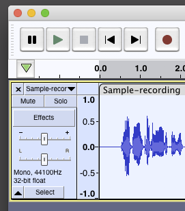

Does your Edit Master sound file say “Mono” on the left-hand panel?
Screen Shot 2023-08-09 at 8.10.30 PM
Yes, is says mono and 44100 hz & 32-bit float…

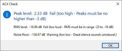

It’s the noise floor… says it’s too low.
When I am doing the ACX Check on the edited file it says it is 76.52 dB but when I bring the mp3 file I created back in… it’s -136.67 (too low - dead silent sounds unnatural).
Here is the original (edited) file:
And this is what it looks like when I bring the same file back in:

There is something very strange going-on here and I’m pretty sure it’s not related to MP3.
Is your “original file” a mono WAV file?
You can easily peak & RMS by reducing 2dB (the Amplify effect at -2dB). That will make your peaks -4.33dB and RMS -18.99.
But the big issue is the noise floor… I don’t know where that (nearly) dead silence is coming from and lowering the volume by 2dB will only make it 2dB worse…
There’s a trick to ACX-Check. It measures noise by plowing through the whole production and picking the quietest part to measure. In plain Room Tone sense, that’s the one place where you held your breath for a second and whatever is there represents, well, the room (plus microphone noise, computer fan noise, etc. etc. etc).
However, if you Generate > Silence anywhere in the production, that will be seen as the quietest part of the show and measured. That’s unnatural and will totally ring bells and be rejected.
Why would they reject complete and total silence? Because that means you messed with the sound and they hate effects, filters, and corrections. Each effect represents an opportunity to distort the sound and be distracting. They hate distractions. That’s one reason Audiobook Mastering can’t be heard while it’s working.
Everything is hooked to everything else.
One other note. ACX has their own, on-line measurement method called ACX Audiolab.
https://www.acx.com/audiolab
It measures the same things as ACX-Check (designed by Audacity), but critically, does not measure noise. Noise is hardest to manage and the most likely to cause you to fail.
It’s not necessary to have a blue denim jacket and no hair.
You measured the wrong file.

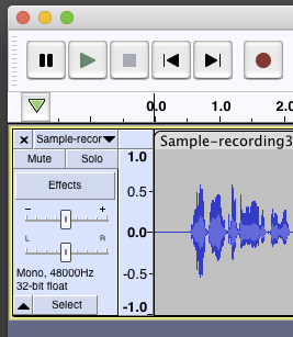

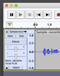

I opened up a clear voice performance in 3,3,3 which does not pass ACX-Check.
-RawPerformance_2023-08-11
Raw_2023-08-11
I resampled it to 44100 and applied Audiobook Mastering.
-SampleRateAndMastered_2023-08-11
Resample-Mastered_2023-08-11

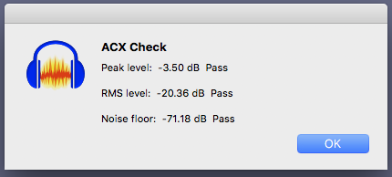

I exported a 192 Constant Quality MP3, opened it, and analyzed it.
AnalyzeMP3_2023-08-11
Perfect, right? Note all the measurements are approximate, but within spittin’-distance of the originals, and it passes.
Except for the sample rate which seems to have snapped back to 48000. One would wonder why it did that.
